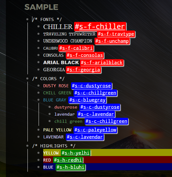

I just started playing with this, and this is what I’ve done so far. I know a bit of CSS, so it was easy to make tags for different fonts, colors, and highlight colors. Similar tags could of course be created for font sizes as well.
Screenshot of the result: http://abiloon.com/wp-content/uploads/2016/09/mystyles.png
Screenshot of the code: http://abiloon.com/wp-content/uploads/2016/09/mycode.png
I can tell I’m going to be going wild with this. Thanks again!

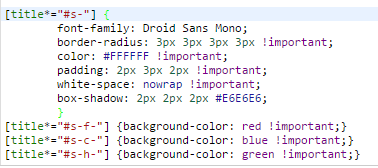

Very nice! What I’ve also found useful is to group similar tags together in classes and sub-classes for ease of referencing and editing even further. So in your example I would prefix all the above tags with “#s-” for “style” tags or even subgroup further to have “#s-f-” for fonts, “#s-c-” for colors and “#s-h-” for highlights. One benefit is the autocomplete that will help you input these tags when you’re editing your document. Another benefit – you can style the tags themselves in groups/classes rather than one at a time. I usually hide these types of tags once I’m done editing the document to have a beautiful outline without the style tags crowding the view. So, if the style tags were grouped as mentioned above the following code would hide them from view (I usually keep this in a separate Stylish to be able to toggle this on/off when needed):
[title*= “#s-“] {color: transparent !important;}
Please make sure you retype the double quotes in “#s-” in the above code if you copy/paste it as WordPress messes with them and renders the code useless.
Thanks @Ksenia! I’m going to try that. One question: what is the syntax for for styling things in groups/classes? (BTW, I looked up !important and now understand why it is important – although my styles were working without it).
Just as listed in my post, title*= makes sure that any item with the title that contains (that’s what the asterisk is for) the string on the other side of the equal sign will get whatever formatting that follows. Here’s the sample where the code is first formatting the tags with the “#s-” prefix (all style tags) and then applying just a different color to each subclass (“#s-f-“, “#s-c-“, “#s-h-“).
Screenshot of the results:
BTW, how did you post an image directly into your comment?
Hey @Abiloon,
It seems that if one pops the image link in after a line break (hitting Enter), the image shows up 🙂 (i.e. no other text in the same line).
It sounds silly, but did you by any chance make a copy of the code while you were modifying this version and its overriding your results? Because I did find that the order in which you turn on the styles does matter. So maybe try turning off all the styles except this one and see if that fixes the issue.
My bad, I didn’t put the !important everywhere. And the !important being in every line defeats the purpose of it (at least in this context) because then the hierarchical approach still rules. Let’s see if any of the CSS gurus know of a workaround. Sorry for the false hope.
@frank.dg, thanks for the tip. And @Ksenia, thanks for taking the time to consider that. In terms of CSS rules, it makes sense, so I don’t expect an easy workaround. An inelegant workaround would be to make lots of slight variations in color and order them in the stylesheet such that any given main color can be replaced with a different subcolor, as in:

This is what is looks like:
